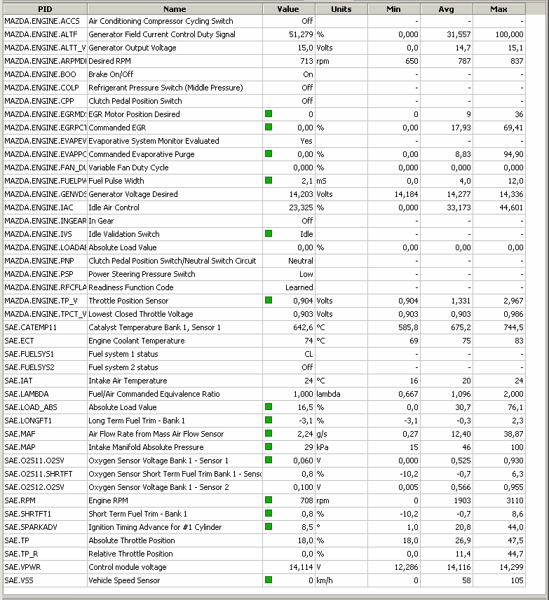

вот выдернул показания при холостых
http://alflash.com.ua/Mazda/log.gif
vasaby
Сообщения: 294
Откуда: Санкт-Петербург
Re: Мазда 3 LF 2.0 2005 год
Сообщение vasaby »
smarty писал(а):вот выдернул показания при холостых
Хотелось бы лог исключительно холостых.
И значение MAF на оборотах отсечки топлива, то есть максимальных.

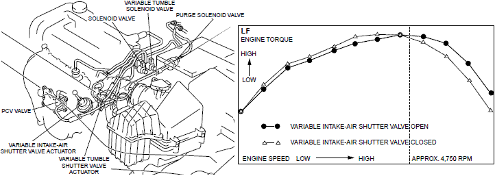

Ненадолго вернусь к теме "геметрии", чтобы окончательно её "закрыть" ;)
Поскольку
At engine speed less than 4,750 rpm (LF)variable intake air shutter valve is closed), то
Under this condition, the effective intake manifold length is from the intake valve to the dynamic chamber.
An inertia charging effect is obtained due to this elongated intake manifold length, air intake volume increases, and higher torque is obtained at low to medium engine speeds
и
VARIABLE TUMBLE CONTROL Operation conditions
• When all of the following conditions are met, the PCM energizes the coil of variable tumble solenoid valve. As a result, negative pressure is introduced to the diaphragm chamber of the variable tumble shutter valve actuator, pulling the actuator rod and closing the variable tumble shutter valve.
— Engine speed less than 3,750 rpm
— Engine coolant temperature less than 63 °C
— Throttle valve opening angle is at the specified value or less (changes according to engine speed)
• The variable tumble system functions to lower emissions at cold-engine start.
• At cold-engine start, the variable tumble system increases intake airflow speed by closing the shutter valve and narrowing the intake passage. As a result, the air-fuel mixture quality from the injector is improved. Additionally, the creation of a powerful air tumble in the combustion chamber promotes the atomization of the air-fuel mixture. Due to this, exhaust emission efficiency is improved.
то проверьте правильность подключения навесного этих двух подсистем: http://alflash.com.ua/Mazda/g136_140.gif
И управляя вручную каждой (отдельно), проверьте "поведение" (отклик) двигателя (в том числе и "по сканеру") на их активацию. М.б. запишите лог-файлы.

ну чтоб показать разницу надо бы знать что замерять..на графиках зависимость крутящего момента от оборотов..обороты я померяю - а чем мерять крут момент в домашних условиях?
Вообще я их проверял. Заслонки изменения геометрии открыты до 4700,после 4700 закрываются, завихрители закрыты до 63.
Но по завихрителям я бы и сам хотел бы сравнить работу мотора с открытыми и закрытыми, он не знаю что измерять((
При снятии текущих данных педаль тормоза была нажата?.
Brake ON/OFF меняется?.

Вы можете перед записью лога создать свой перечень параметров*, которые надо вводить (записывать) с тем, чтобы убрать не существенные (в данном случае)?
И если не затруднит, запишите отдельный лог с параметрами* "OBD-II", а не "Mazda Enhanced". Это несколько упростит анализ некоторых возможных причин и возможно увеличит скорость обмена данными между БУ и диагностической прогой.
Как по мне, то сейчас под наибольшим подозрением -недостаточное количество воздушно-топливной смеси".
Не смотря на то, что MAF Max доходит до 46 г/сек ...
И остается открытым вопрос анализа пульсаций во впускном коллекторе.
Бум рыть дальше ;)
В вашем скрине (http://alflash.com.ua/Mazda/log.gif) отмечены нужные ("для начала")
Запишите логи при этих режимах (все при прогретом двигателе на неподвижном авто и в движении).
  • 1. Без нагрузки.
    а) ХХ 4-5 сек,
    б) резкое нажатие на педаль газа и быстрое её отпускание,
    в) ХХ 5-8 сек,
    г) удержание оборотов (по 5-8 сек) примерно при 1500-2500-3500-?
    д) ХХ 5-8 сек
    2. Под нагрузкой I (при движении).
    Резкий старт при полностью нажатой педали (aka WOT). Например на первой или со второй передачи. И после "накат" на нейтралке.
    3. Под нагрузкой II (придвижении).
    Резкий старт с переключением передач (типа "злобный спортивный" стиль). И после "накат" на нейтралке.
Обязательно комментарий к каждому файлу ("что и как делалось").
И главное, "всё внимание на дорогу!"
Кстати, диски/резина штатные?
* p.s. И добавьте в перечень и такие параметры:
- Intake manifold runner control
- Intake manifold tuning valve
- Input voltage from MAF sensor
При использовании режима OBD-II
- LOAD
- Short term fuel trim
- Long term fuel trim
- Engine speed
- Vehicle speed
- MAF
- Absolute TP
- Input voltage from front HO2S
- EGR valve control signal
- Purge solenoid valve control signal
- Estimated catalyst converter temperature
