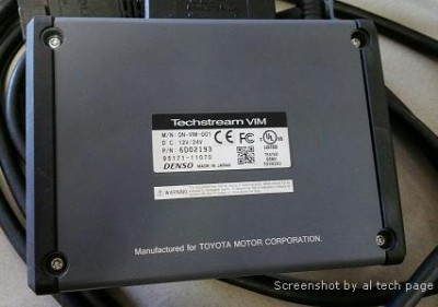

p.s.s. VIM by Denso
VIM by Denso
VIM by Denso
Denso
Denso DST-i Vehicle Commumication Interface<br />Photo by Kevin Winnipeg, Canada
Description:
Product Description for DST-i
Design for USB 2.0
Power consumption: Normally 1.5W (12 VDC), Max. 2.5 W (12 VDC)
Operating temperature[Storage temperature]: 0-50°C [-10 to 60°C]
Operating humidity: 35-85% (No condensation)
Weight: Approx. 160 g
DST-i (Denso)
