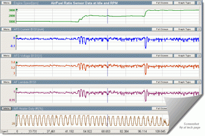

A/F Ratio sensor at Idle and RPM

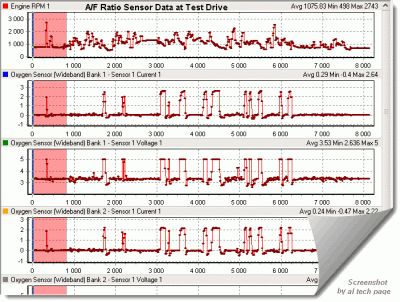

A/F Ratio sensor at Test Drive
