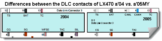

(1) Using SST, connect the terminals Ts and CG of DLC3* (pins #14 and #4)
(2) Turn the ignition switch ON.
  • HINT: Place the vehicle in a stationary condition with the shift lever in P range.
(3) After turning the ignition switch ON, check that the VSC warning light is lit for about 4 sec. and then starts quick blinking at 0.13 sec. intervals. (4) After ensuring the blinking of the VSC OFF indicator light for 2 sec., turn the ignition switch OFF. (5) Remove the SST and make the terminals Ts and CG of DLC3 disconnected.

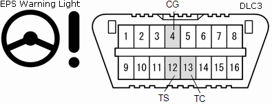

* Примечание. Расположение контакта TS в авто с CAN-OBDII:
Для справки. Расположение контакта TS в авто предыдущего поколения:
CG_SG pin of Toyota DLC3
Lexus LX470 DLC3 pins

CALIBRATION OF TORQUE SENSOR ZERO POINT (USING SST CHECK WIRE) on AVENSIS
RM1018E писал(а):HINT: Perform this operation in the following cases.
• When removing and installing ”steering wheel assembly”, ”tilt steering column assembly” and ”steering gear assembly”.
• When replacing power steering ECU assy.
(a) Place front wheels and steering wheel facing straight ahead.
(b) Perform the torque sensor zero point initialization.
HINT: If the power steering ECU assy is replaced, initialization is not necessary.
(1) Stop the vehicle and turn the ignition switch OFF.
(2) Using SST, connect terminals Ts and CG of DLC3. SST 09843–18040
(3) Using SST, connect terminals Tc and CG of DLC3. SST 09843–18040
(4) Turn the ignition switch ON.
(5) Disconnect and connect the terminal Tc of DLC3 20 times within 20 seconds.
(6) Check the DTC C1515/15 output.
Perform the torque sensor zero point calibration.
HINT:
• Do not touch the steering wheel.
• Check that the DTC for except C1515/15 is not output.
(1) Stop the vehicle and turn the ignition switch to OFF.
(2) Using SST, connect terminals Ts and CG of DLC3 and turn the ignition switch to ON. SST 09843–18040
(3) Disconnect the SST. SST 09843–18040
(4) Check the DTC is not output.

С помощью SST соедините контакты 12 (TS) и 4 (CG) на DLC3.
ПРИМЕЧАНИЕ: Во избежание выхода системы из строя обратите особое внимание на выбор соединяемых контактов.
Включите зажигание (IG), а затем не менее 20 раз соедините и разъедините контакты 13 (TC) и 4 (CG) в течение 20 с.
Включите зажигание (IG), а затем соедините контакты 13 (TC) и 4 (CG).

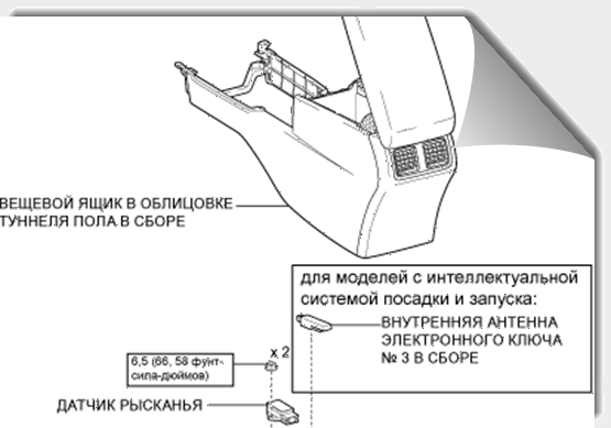

Всем доброго вечера. Имеет меня вот такой авто с кодом С133шесть.
Калибровка не проходит или кривые руки. Сначала пытался сканером, делаю сброс, неисправность уходит, калибровка и маемо то що маемо. Чтобы ускорить процесс, взял скрепку, ресечу блок, неисправность уходил, лампочка гаснет, но калибровка не проходит. Что я только не делал, и ручник включал и секунды держания увеличивал.Получаем два варианта, или сразу калибровка датчика не прошла или трогаюсь в боксе 10см и имеем лампочку со скользкой дорогой. Может кто то знает волшебное слово?
LC 2013MY, DTC C1336
Видимо не выполняются все необходимые "шаги" калибровки.
Детально опишите последовательность своих действий (при калибровке), покажите контекстные логи, Health Check Results* и предысторию возникновения неисправности. И только тогда можно будет определить "что именно не хватает в супе".
Чем именно (кроме скрепки) калибруете, каким сканером?.
Для справки. Note to "Zero point calibration sensors of Toyota/Lexus" смотрите в viewtopic.php?f=18&t=248
DTC of VSC C1336 (Lamp Code 39) в этом авто для стран Персидского залива означает "Zero point calibration of Deceleration Sensor undone".
    • "Для того, чтобы что-то запомнить, надо что-нибудь забыть"
Видимо клиент отвалил, но описание такой процедуры, e.g. for LC TRJ150, может быть полезно другим :)

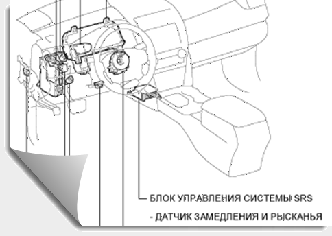

ВЫПОЛНИТЕ КАЛИБРОВКУ "НУЛЯ" ДАТЧИКА ЗАМЕДЛЕНИЯ И РЫСКАНЬЯ И ДАТЧИКА УГЛА ПОВОРОТА РУЛЕВОГО КОЛЕСА (при использовании диагностического жгута проводов SST aka "скрепка").
  • ПРИМЕЧАНИЕ:
    • Примите меры, чтобы в процессе калибровки "нуля" датчика автомобиль оставался в неподвижном состоянии. Не наклоняйте, не перемещайте и не трясите его (не запускайте двигатель).
    • Описываемые действия необходимо выполнять на ровной поверхности (с наклоном менее 1%).
а) Сбросьте калибровку "нуля" датчика.
  • i. Выключите зажигание.
    ii. Убедитесь, что рулевое колесо установлено в центральное положение.
    iii. Для моделей с механической трансмиссией: Убедитесь в том, что рычаг переключения передач находится в нейтральном положении, и включите стояночный тормоз.
    Для моделей с автоматической трансмиссией: Убедитесь, что рычаг переключения передач находится в положении Р.
    iv. Включите зажигание (IG).
    v. Контрольные лампы ABS и SLIP загораются на 3 с, чтобы проинформировать водителя о том, что первоначальная проверка завершена.
    vi. С помощью SST соедините и разъедините контакты 12 (TS*) и 4 (CG) разъема DLC3 не менее 4 раз в течение 8 с
    vii. Убедитесь, что контрольная лампа SLIP загорелась.
b) Выполните калибровку "нуля" датчика замедления и рысканья.
  • ПРИМЕЧАНИЕ:
    • - Если рычаг переключения передач не находится в положении P (для моделей с автоматической трансмиссией), или не включен стояночный тормоз (для моделей с механической трансмиссией), будут зарегистрированы коды DTC 36 (не выполнена калибровка "нуля" датчика рысканья) и 39 (не выполнена калибровка "нуля" датчика замедления).
      • Если выводится DTC, указывающий на то, что калибровка "нуля" датчика не завершена, повторите процедуру, начиная с удаления данных калибровки "нуля" датчика и системной информации.
    iv. С помощью SST соедините контакты 12 (TS) и 4 (CG) на DLC3.
    vi. Оставьте автомобиль в неподвижном состоянии на ровной поверхности на время не менее 5 с.
    vii. Убедитесь, что контрольная лампа SLIP загорается на несколько секунд, а затем мигает по схеме режима активной диагностики (0,125 с включена и 0,125 с выключена).
    • УКАЗАНИЕ:
      • Если контрольная лампа SLIP не мигает, выполните калибровку "нуля" датчика повторно.
      • После перевода системы в режим активной диагностики калибровку "нуля" датчика можно выполнить только один раз.
      • Калибровку невозможно выполнить повторно, пока из памяти не удалены сохраненные данные.
