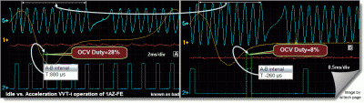

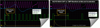

1AZ-FE CKP vs. CMP Waveform at Idle and Acceleration
Misfire_Data
VVTi operation at idle vs. Acceleration
