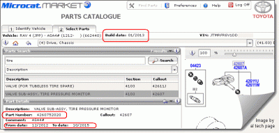

RAV4 a'013 Tire Pressure Monitoring Valve  OEM Part.No.
