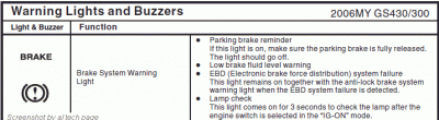

off.
Brake control warning light

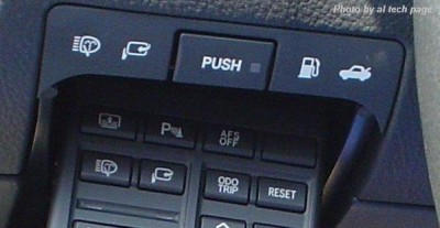

GS300 AFS Off Switch
