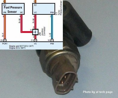

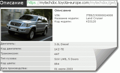

Off. To Prado 120-2003г (JTEBZ29J900024928) 1KD-FTV
Fuel Pressure Sensor of LC Prado 120,2003MY (JTEBZ29J900024928) 1KD-FTV
Fuel Pressure Sensor of 1KD-FTV (LC KDJ120 a'03)
ECM pins of 1KD-FTV (LC KDJ120 a'03)
VIN
VIN
