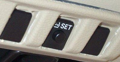

Я правильно понимаю, что речь идет о кнопочке под рулем, которая начинает процесс (та что желтым на картинке ниже)?

Эта кнопка НЕ начинает процесс регистрации новых датчиков.
Initialization/“SET” Switch aka Tire Pressure Warning Reset Switch
Процедура INITIALIZATION (и манипуляции с Initialization/“SET” Switch*) проводится ПОСЛЕ выполнения REGISTRATION. Но она пока неактуальна, поскольку система выдаёт Вам сообщение о "Error ID Registration".
HINT:
*: Perform initialization after the transmitter ID registration is completed
Если это не так, покажите первоисточник или скрин, в котором показано необходимость использования этой кнопки при проведении REGISTRATION.
Reference. http://alflash.com.ua/Learn/tpws_gs300a ... %20repair/
Tire Inflation Pressure Compensation and AdjustmentT-SB-0345-08.rar
(143.39 КБ) 769 скачиваний
* Tire pressure warning reset switch. Enters the initialization mode for tire or wheel replacement.
  • • By operating the tire pressure warning reset switch, the tire pressure warning ECU can be set to issue a warning at an inflation pressure that corresponds to the type of tires.
    Therefore, the dealer must set the warning threshold to the proper value in order to
    comply with local regulations.
    • Operate the tire pressure warning reset switch only after the inflation pressures of all tires
    (including the spare tire) have been adjusted on the vehicle.
    • To initialize the system, press and hold the tire pressure warning reset switch for 3 seconds or longer with the engine switch on (IG). When the system receives the initialization signal, the warning light blinks 3 times (1 second on, 1 second off).
    • During initialization, the tire pressure warning valve and transmitter measures the inflation pressure of the tires, and registers the signals that are transmitted into the tire pressure warning ECU at a frequency of once per minute. The initialization process is completed when signals from all tires (including the spare tire) have been received.

Об этой кнопек я говорил только в контексте инициализации и только потому, что в начале процесса регистрации говорится, что регистрация не будет проведена, если компьютер находится в этот момент в режиме инициализации. Но это, как я понимаю, не мой случай. Выкладываю логи с положением переключателя в летнем и зимнем режиме. Сломаный датчик у них общий :(

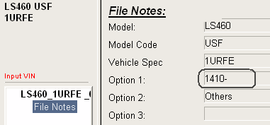

Офф. Ваш авто выпущен после 10.2014?
Не исключаю (проверю позже), что в авто 2014MY используются датчики с 8-разрядными номерами (TRW System Type):

По поводу 1410 - да, там нужно было выбрать другую опцию. К слову я пробовал. Не помогло ничего. Я начинаю склоняться к мнению, что мой MiniVCI шнурок просто не может прописать датчики, хоть в интернете и масса инфы, как люди на тойоты прописывали.
