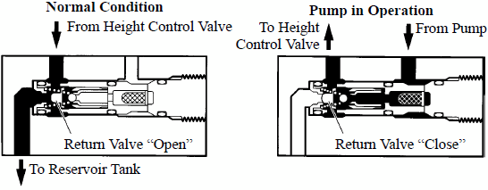

vadimf писал(а):При включении насоса на автомобиле путем подачи питания через реле, давление подымается до 19мпа и сгорает предохранитель и после этого давление падает до 0. Существует клапан удерживающий давление в системе и где он стоит в компрессоре? Что посоветуете?
Notice.
  • • Be careful of fluid spray when the height control pump and motor is operated.
    • Do not allow the motor to operate for 60 seconds or more.
    • If the height control pump and motor is shorted, locked, or has a similar type of malfunction, a large amount of current will be flowing.
Return Valve.
The return valve opens and closes the fluid passage between the height control valve and the reservoir tank. The return valve has been simplified by adopting a construction in which the valve is closed by the flow of the discharged fluid.
Normally, a spring force is applied to the return valve to maintain the fluid passage between the height control valve and the reservoir tank open.
When the pump operates in order to raise the vehicle height, the pressure of the fluid that is discharged by the pump causes the return valve to move to the left of the diagram as illustrated.
Accordingly, the fluid passage between the height control valve and the reservoir tank closes, and the fluid that is discharged from the pump flows towards the height control valve.
Return Valve
Return Valve
return valve.gif (13.22 КБ) 15538 просмотров
