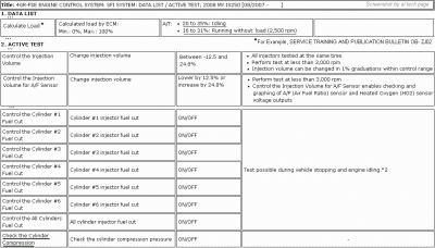

- Calculate Load and Active Test for 4GR-FSE (D-4) Engine
- Active Test "A/F Control"
О Air/Fuel Control and Injection volume Active Test Rules см. в
viewtopic.php?f=16&t=647&start=54#p10257
