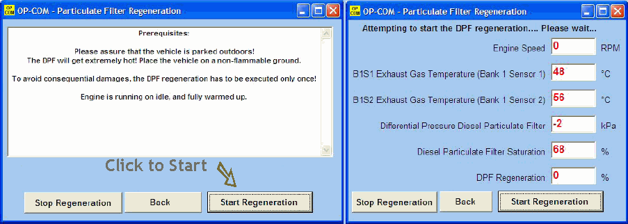

Итак, для того Opel Astra легкими нажатиями соответствующих "кнопок" диагностического сканера, выполните следующее:
И не морочьте голову простым людям и коллегам! Процедуру регенерации сажевых фильтров надо выполнять, а не заставлять БУ закрывать глаза на его заСАЖЕнность!
Для справки. Видео о DPF cv/ в http://alflash.com.ua/avtovideo/dpf/dprn.html и эти сюжеты:
Примечание. У других производителей аналогичные процедуры еще проще.

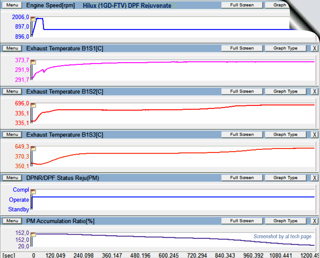

PM FORCED REGENERATION.
a) Clear the DTC and Exhaust Fuel Addition FB value by disconnecting the cable from the negative (-) battery terminal or removing the EFI MAIN No. 2 fuse for 60 seconds or more.
Tech Tips
  • • The accumulated PM volume stored in the ECM cannot be initialized using the intelligent tester.
    • To perform PM forced regeneration, it is necessary to perform initialization of the accumulated PM volume stored in the ECM.
b) Connect the intelligent tester to the DLC3.
c) Start the engine and drive the vehicle until the engine coolant temperature reaches 60°C (140°F) or more.
d) Move the shift lever to N and set the parking brake.
e) Turn the tester on.
f) Enter the following menus: Powertrain / Engine and ECT / Active Test / Activate the DPF Rejuvenate (PM) / Data List / Diesel Exhaust / Exhaust Temperature B1S2.
g) Perform the Active Test while the vehicle is driven at a constant vehicle speed within 50 to 100 km/h (31 to 62 mph) (transmission in 3rd gear) for more than 15 minutes.
  • Tech Tips. While the "Activate the DPF Rejuvenate (PM)" Active Test is being performed, the accelerator opening angle should be kept as constant as possible.
    CAUTION: Be aware of excessive heat on and around the exhaust pipes during PM forced regeneration.
    Note. If PM forced regeneration stops, repair the malfunction that caused it to stop, and perform it again to complete the operation.
Tech Tips
  • • PM forced regeneration completes in 15 to 40 minutes.
    • PM forced regeneration time changes depending on PM Accumulation Ratio and driving conditions.
    • A fail-safe stops PM forced regeneration if Catalyst Differential Press increases too much during regeneration
    • Exhaust Temperature B1S2 becomes 500°C (932°F) or more within 20 minutes of PM forced regeneration start.
    • PM forced regeneration will be stopped if the accelerator pedal is depressed during regeneration. In this case, PM forced regeneration needs to be performed again.
    • Even if PM forced regeneration stops while it is occurring, the intelligent tester displays Compl (complete) for DPNR/DPF Status Reju (PM).
h) Check if the temperature increases or abnormal white smoke occurs during PM forced regeneration.
Update. Фрагмент выполнения процедуры принудительной регенерации DPF Hilux (GUN126) с 1GD-FTV Engine:
