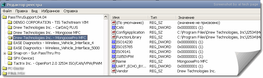

OpenPort 2.0

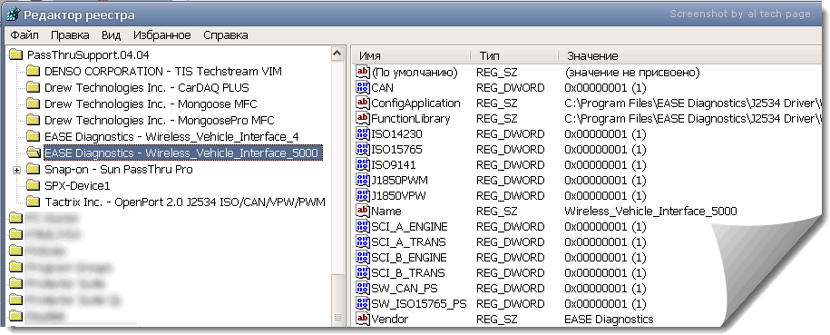

EASE

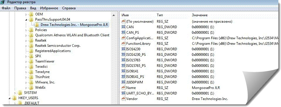

MongoosePro® Jaguar-Land Rover
