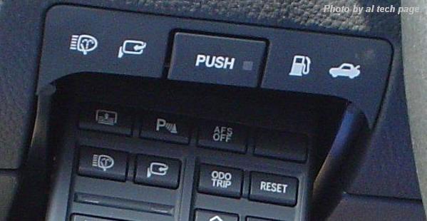

off.
Brake control warning light
GS300 AFS Off Switch
