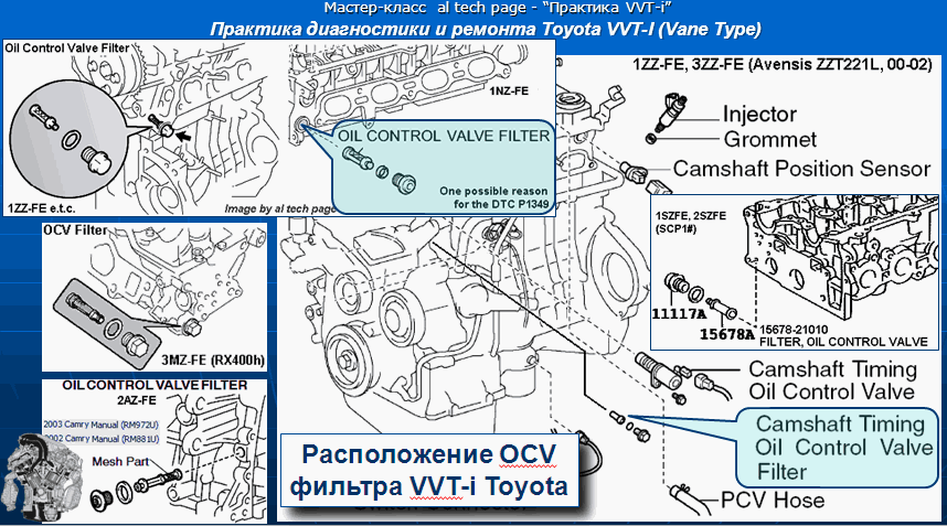

OCV_filter 1NZ-FE
OCV_filter 1NZ-FE
VVT-i OCV Filter Location 1

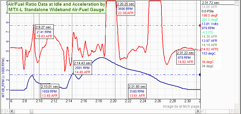

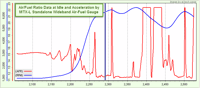

Air/Fuel Ratio Data from Innovate MTX-L Standalone Wideband Air-Fuel Gauge

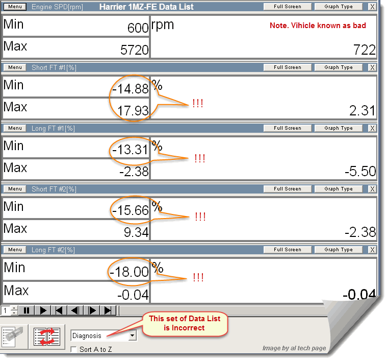

Harrier Data List
Harrier Data List
Harrier Data List
